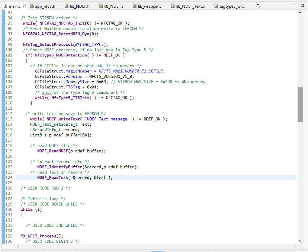

Why am I unable to read NDEF information in the STSW-ST25001 APP using the following code, with no messages being displayed?

Hello,Mr.TIDAL
.I'm using NUCLEO-L476RG and X-NUCLEO-NFC07A1, Write text information into NDEF

yes, I used app named STSW-ST25001,Here are the links:STSW-ST25001 - Application executable of the "NFC Tap" Android app for ST25 product family - STMicroelectronics. But I did not implement the app to read NDEF messages with the above code, What should I do?

HI,
As you can see, I need to write NDEF data to the STM32 CUBE IDE by NUCLEO-L476RG, Instead of writing through an application. I wrote the code above in order to write the message, but ST25 NFC tap app have not a single NDEF message, Please help me check whether the above code is correct and achieves the functions
2023-03-22 8:51 AM
a working example of NDEF writing is provided in X-CUBE-NFC7: NDEF_URI. I would suggest to first compile and run this example and then read the NDEF with the NFC tap app. Once this is working, just modify the MX_NFC7_NDEF_URI_Init function to write your own NDEF.

2023-03-29 4:43 AM
I compile and run this example and then read the NDEF with the NFC tap app.But is not working, the tap does not have any information
2023-03-29 7:31 AM
see § 1.2 Board setup in the UM2960 (Getting started with the X-NUCLEO-NFC07A1 NFC/RFID tag IC expansion board based on ST25DV64KC for STM32 Nucleo). Make sure the ST1 connector is in place on the 3.3V position. If you do not have a jumper, just put a wire between the middle pin and the 3.3V pin of the ST1 connector.
Without this jumper, the ST25DV device is not powered and the I2C communication is impossible.
