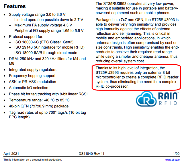

2024-07-17 2:12 AM - edited 2024-07-17 2:30 AM
@JFran.2 wrote:Do you have any MCU/MPU that supports UHF RFID reader/writer?
What do you mean by, "supports" ?
As @Ulysses HERNIOSUS said, the ST25RU3993 isn't an MCU/MPU anyhow; and, as the datasheet says, you can use pretty much any MCU/MPU with it:
I think the same applies to most RFID chips - they have standard interfaces allowing them to be connected to any microcontroller.
