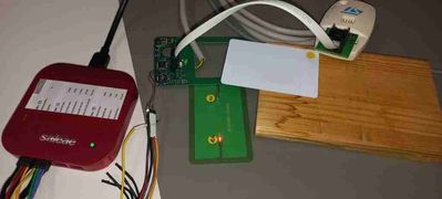

2024-10-08 11:54 PM
Hi Ulysses,
this ist my setup:
The test is to read cyclic the UID of the chip card. I have made 2 tests:
Please see zip file with both logic analyzer traces. These traces are monitored with saleae logic analyzer. You can download the software at https://www.saleae.com/ for free.
Regards, Andy
