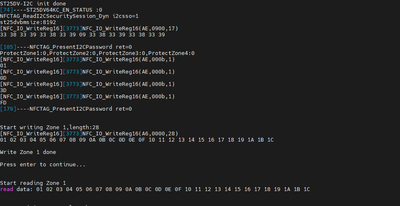

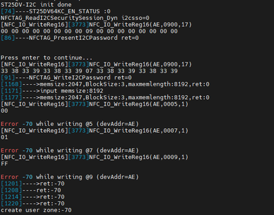

After reading the data through the ios NFC Tap app, the Linux platform can't read or write data to the ST25DV64KC through the iic.
Below is a log of the app after it was read and operated with linux
Below is the log that is not read with the app and operated directly with linux
Anyone who can help with this would be appreciated
