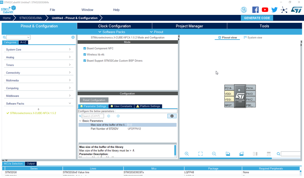

2020-06-03 9:20 AM
Hello Mark,
Indeed, the CubeExpansion contains some ready to use examples for the mentionned series.
but if you use CubeMX, you could generate some code compatible with G0.
please, select a G0 MCU or associated board, click on start a project
go to "additional Software" panel and choose STMicroelecontrics.X-Cube-NFC41.5.2 .
Select the components that you want / need , resolve dependencies, click on ok
You should get the following result
Enjoy

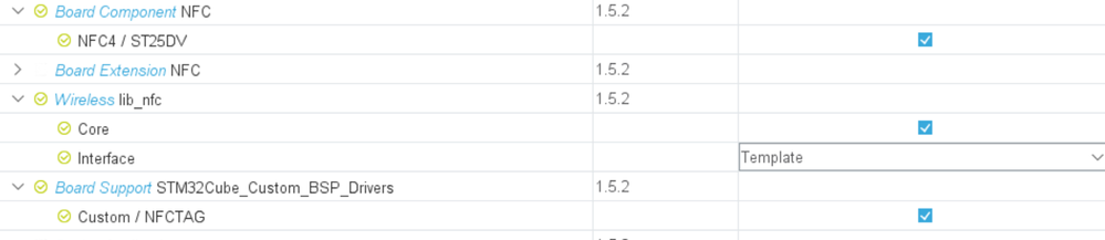

2020-06-04 4:45 AM
Hello Mark,
Kindly select Interface as "Template" instead of "Basic" in Addition software setting for NFC4. Since for custom board implementation Template is used as interface
Best Regards
Rahul

2020-06-04 4:16 PM
Hi Rahul,
It works after I verified.
Thank you for help!
Mark
