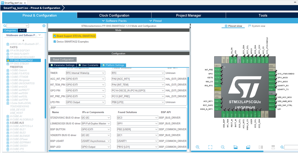

- start new project in CubeIDE and select "STEVAL-SMARTAG2"
- set inputs/outputs as default (press OK when pop-up window ask me if i want to keep it)
- middleware/software package... download and select FP-SN-SMARTTAG2
- define platform settings (picture below)

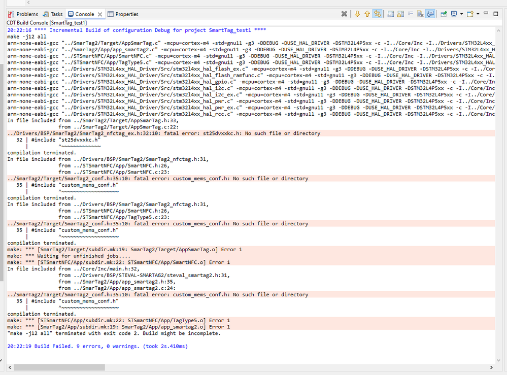

- save and run the compiler and get an errors (picture below)
It looks like I miss something?

Then, the details described are not sufficient to well identify the problem.
The file SmarTag_test1.ioc (STM32CubeMX configuration file for the generated project ) will be necessary.
What can be said is that:
I hope this helps,
