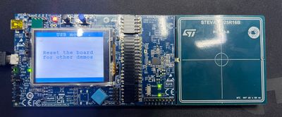

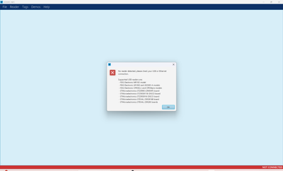

I recently purchased the STEVAL-25R3916B board and it functions correctly with the out-of-the-box demo. However, I’ve been unable to get it working with any of the available software tools, such as the ST25R3916 Discovery GUI or ST25-PC.
I’ve confirmed that JP14 is correctly configured, the board is set to USB mode, and I’m using the correct USB port as per the documentation. Despite this, the software does not detect the board.
From what I’ve seen in the forums, this appears to be a recurring issue, but I haven’t come across any clear or official resolution.

please confirm that:
- the following message is displayed on the screen:
- the USB is connected on "MCU USB" (type B connector):

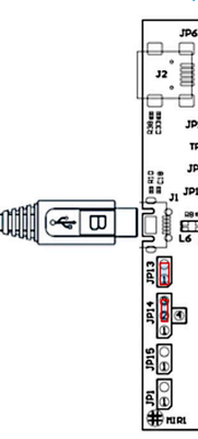

- JP14 and JP13 are in the position indicated as red on the picture

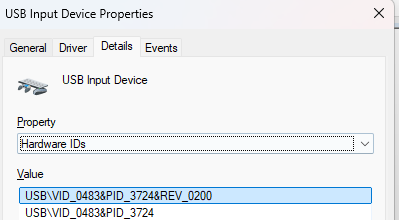

- you can see USB input device with the following VID/PID in the device manager:

1- USB connections and jumpers were done correctly:

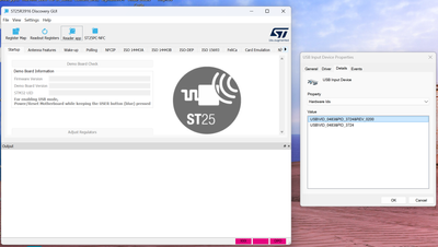

2- USB Device is identified as you have shared, but none of the apps can use it.

you checked already pretty much everything. Which leaves me puzzled. Last time such issue was resolved by moving from a power-only USB cable to a data USB cable. But the device is even enumerated in your case....

Thanks for your reply. After testing the module with a non-company PC, the USB mode functionality works as expected. It seems that the issue was a company group policy or something of similar nature.
