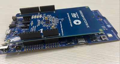

I'm using an X-NUCLEO-NFC03A1 board with an nRF52840DK. I'm running my own driver on Zephyr and I'm able to read tags by polling. I plan to set the chip in the tag detector WFE so that once a tag is detected, it can wake up the host to handle the tag.
The problem is it always returns immediately after I send the Idle command even if there are no tags.

The nRF52840DK is compatible with the Arduino Uno Rev. 3 standard so they are wired with the connector.
The 3V3 supply on CN6.2 and CN6.4 are different pins, as well as GND. But they are connected on the nRF52840 respectively.

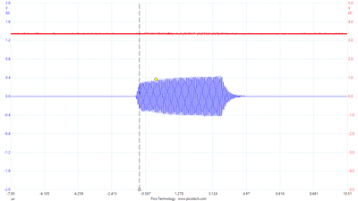

The normal behavior is the following:
When entering in WFE mode for a given calibration step, [<Maxsleep> + 1] bursts of <SwingsCnt> pulses at 13.56MHz are transmitted every tINACTIVE milliseconds. tINACTIVE is (<WUPeriod> + 2) x tREF with tREF=8ms and therefore tINACTIVE is 16ms (this is actually closer to 17ms due to some processing after each burst). So, with <Maxsleep>=1 and <SwingsCnt>=63, there are 2 bursts of 63 RF pulses transmitted every 17ms and then a response is returned.
The burst can be observed on a scope (just connect the gnd of the probe to the tip of the probe and put the probe in the field and you should be able to capture the field):

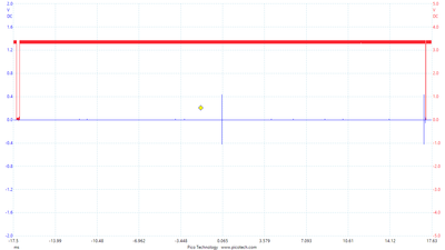

The full sequence for 1 step of calibration is:
The red signal is the SPI CS. The first low red pulse on the SPI CS is the Idle command transmission, then 17ms later the first burst is sent in blue, then 17ms later the second burst is sent in blue and the second low red pulse on the SPI CS corresponds to the response to the Idle command. So a response arrives ~34ms after the Idle command.
I suspect that the transmission of the first burst causes a voltage drop that resets the ST25R95 chip. Can you try to probe the field and check whether you see part of the burst 17ms after the Idle SPI CS pulse? See also the table 47 of the datasheet for the 100mA peak current during burst detection. Can you try to supply the 3V3 of the ST25R95 from an external lab supply (just bend the CN6.2 and CN6.4 pins)?

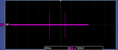

2024-01-15 2:17 AM
I am using wires to connect the MCU board and X-NUCLEO-NFC03A1 now.
Seem that the interval of the 2 bursts is more than 200ms in my tests. I forgot to trace SPI CS, will confirm it later.
