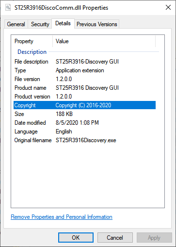

2021-11-29 8:53 AM
this is the snapshot of the DLL details:
v1.2.0.0
