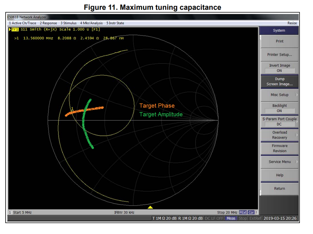

The target phase algorithm can be beneficial if you want to end up with the same/ good wave shapes along de-tuning.(dependent on how much your antenna will be de-tuned.
The target amplitude you can ensure a certain target matching impedance and therefore output power - if reachable over de-tuning.
The target phase should for example find a matching impedance along the orange line and the target amplitude along the green line.
If you would combine both algorithm using a weighting function, it should be possible to target an exact target matching impedance.
