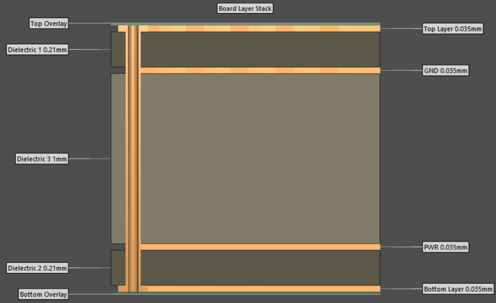

I am currently designing an NFC reader PCB based on the ST25R3916B. Could you kindly share the recommended PCB stack-up configuration and the routing guidelines for the NFC antenna? I have also attached images of the PCB layer stack-up that I am currently using. Could you please review them and confirm whether it is appropriate?

This is our recommended PCB layer stack:
Information about our PCB layout guidelines can be found in the associated application note.
For Example ST25R500: AN6279 - Layout recommendations for the design of boards with the ST25R300,
ST25R501 and ST25R500 device
This AN6279 will soon receive an update to also cover the ST25R210.
BR Travis

did you find the appnotes on https://www.st.com/en/nfc/st25r3916b.html#documentation ? E.g. AN5240 Layout recommendations for the design of boards with the ST25R3916/16B, 17/17B, 18, 19B, and 20/20B devices and AN5584 ST25R39xx NFC reader thermal design and AN5276 Antenna design for ST25R3916/16B, ST25R3917/17B, ST25R3918, ST25R3919B, and ST25R3920/20B devices among others.
Also please feel free to inspect the layout files for our demo boards.
Please let me know if these documents answer your questions!
BR, Ulysses
