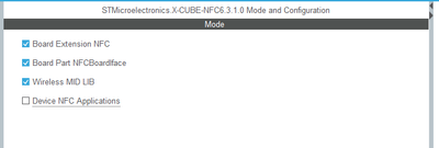

Also, in CubeMX / CubeIDE I can see the following configuration options (see screenshot).
However, I'm unsure what to select in terms of the “Board Extension” and “Board Part” settings. Since I’m not using any ST eval board, just the bare ST25R3916B, I don’t know which options are still relevant, and which might introduce unwanted dependencies.

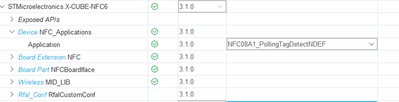

The Device NFC Application has not been selected in your setup:
Make sure to select it if you want the demo being included. In your case this is the ndef_demo as the NDEF application has been selected:
I've seen that the FreeRTOS is being used. I would suggest you have a look to the FreeRTOS demo inside the ST25 embedded NFC library.

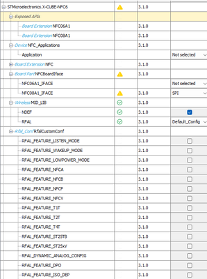

2025-06-17 12:51 AM
Thank you for the fast reply @Brian TIDAL
When i activate "Device NFC Application" it wants me to specify the UART and User BTN Pins (see picture below). The Problem is that i don't have these implemented on my PCB. I only have the ST25R3916B IC. When i leave the "Found Solutions" as undefined it will give me multiple Build Errors.
2025-06-17 4:27 AM
yes I've seen you do not have any free pins (except if you reassign some of GPIO_output e.g. PA2/PA3 for USART2 and PC13 for the button).
Anyway, the generated application is designed for bare metal and will probably not run with FreeRTOS. I recommend again to have a look to the FreeRTOS demo inside the ST25 embedded NFC library and to port from STM32L4 to STM32F0.
