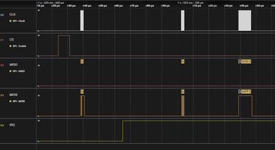

In rfalInitialize() -> st25r3916Initialize(), the issue occurs when trying to measure voltage with st25r3916MeasureVoltage(). After executing st25r3916ExecuteCommandAndGetResult, I get the below SPI trace. The IRQ line goes high as expected, the RFAL then sends a read request for registers 0x1A through 0x1D, and the ST25R3916B does not respond with any active IRQs and does not clear the IRQ line. This results in a memory access violation on the nRF5340.
This is the standard, unmodified RFAL for ST25R3916/B. The DCT interrupt is enabled. The SPI trace looks exactly the same as a previous IRQ read. Is there something different about the Measure Power Supply (0xDF) command? Any help would be appreciated.

to me it looks there is no CS transition before sending the Read Interrupt status reg command:
Br, Ulyssses

I hadn't noticed what Ulysses pointed out; no CS transition after the command may very well be the issue. My CS deselect port doesn't fail anywhere else, but I'm going to try a different method just in case.

csv is hard to read, better share the original Saleae file inside a zip.
The missing CS positive pulse is highly likely the reason for the Interrupt status register read not being correctly executed.
Ulysses

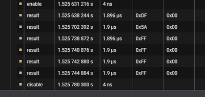

I think you're right, but it's not (directly) about the missing CS positive pulse. Here's where I'm at:
During step 3, the SPI peripheral attempts to put the 0x83 into a nullptr, causing a memory access exception. What I don't understand is why the next four 0xFFs were sent, as the host should have already crashed.
The .sal is attached. .zip and .sal aren't allowed, so I changed the extension to .log. Just change it from .log to .sal and it should open fine.
