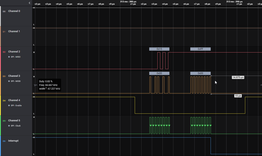

I also suggest to connect a logic analyzer on SPI (CLK/MOSI/MISO/CS) + IRQ so that I can investigate from your trace.

2022-09-13 1:01 AM
looking at the trace the SPI in the logic analyzer is incorrectly configured. Below picture has it properly configured (signals and trailing edge).It also shows that the interrupt service routine is not being executed (INT line gets cleared by masking the interrupts(15-ff). The routine seems to try to enable the field repeatedly.
Better to concentrate only on the initialization routine in the beginning.
