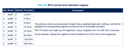

I relied on the documentation at this chapter : 1.3.40 RFO normal level definition register page 80 in the Datasheet - ST25R3911B - High performance HF reader / NFC initiator with 1.4 W supporting VHBR and AAT
And, if i understand well if i write 0x00 in the 0x27 register it will enable all Ohms segments, it will make 510 ohms.
If i write 0x01 510-256=254 right ?
But when I test my application with a field detectorit it doesn't seem to react as expected.
Am I doing something wrong ?

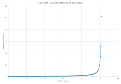

the segments of the drivers are parallel. Thus you also need to apply calculation of parallel resistors, not series resistors (check e.g. https://en.wikipedia.org/wiki/Resistor).

Hello Ulysses,
Thanks for help
If i understand well the value of the resistance depending on the register looks like this ?
Regards,
Yvan
Correct.
