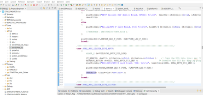

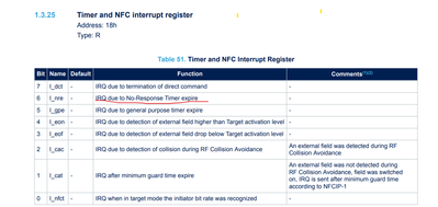

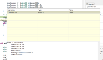

no response interrupt keep on triggering continuously after some time. please help in knowing the reason for this scenario.st25r3911b ic we are using and tag we are using st25tv

Hi salugu,
the demos as is are running and reading NFC-V tags. So the default delivered binaries should work, do they? Did you port it to a different MCU? Any other changes? In case this happens only after porting - please provide logic analyzer traces.
The no response interrupt is normal when there is no tag. Even in case the tag is there this error may still happen depending on the command sent.

2023-08-04 11:32 PM
2023-08-04 11:43 PM
this error keep on triggering even after tag is removed
