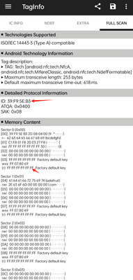

Currently I use nfc5 demo to read T2T card, but the read often fails,The code is as follows.When NFC-A is detected, the type is 0, and the card is considered to be T2T
These cards are detected in the code as T2T type, and there is no encryption, and I can see from the app read that the keys are all 0xFF,I wonder what went wrong, thanks

such tags are not true T2T tags as a proprietary three pass authentication is required before memory operation. See https://community.st.com/t5/st25-nfc-rfid-tags-and-readers/nfc0541-read-mifare-classic-1k/td-p/255197 for similar question. I would suggest to use true T2T tags such ST25TN rather that tags with proprietary authentication and ciphering which are broken since several years.
Rgds
BT
