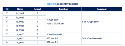

However, the program execution hangs indefinitely inside the rfalNfcInitialize() function which I later on traced it to the st25r200Initialize() function. I have also successfully checked the correct execution of SPI communication by reading IC ID at 0x3F (= 0x54) without any problem. The program hangs before st25r200InitInterupts() routine is called according to me, since I am not getting the debug output in that I inserted in that function.

0x54 is not the correct value of the IC identity register:
Thus st25r200CheckChipID() returns false and causes the entry to the Error_handler function:
The incorrect IC identity register value is likely caused by an incorrect SPI configuration. Make sure CLKPolarity = SPI_POLARITY_LOW and CLKPhase = SPI_PHASE_2EDGE in your SPI configuration. See section 5.8.2 in the ST25R200 datasheet: "The ST25R200 has a standard serial peripheral interface with clock polarity of 0, a clock phase of 1, and an active low slave select signal. "
