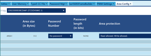

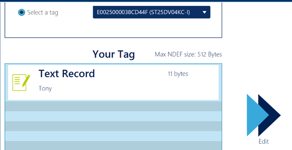

NDEF
EVK used
CC

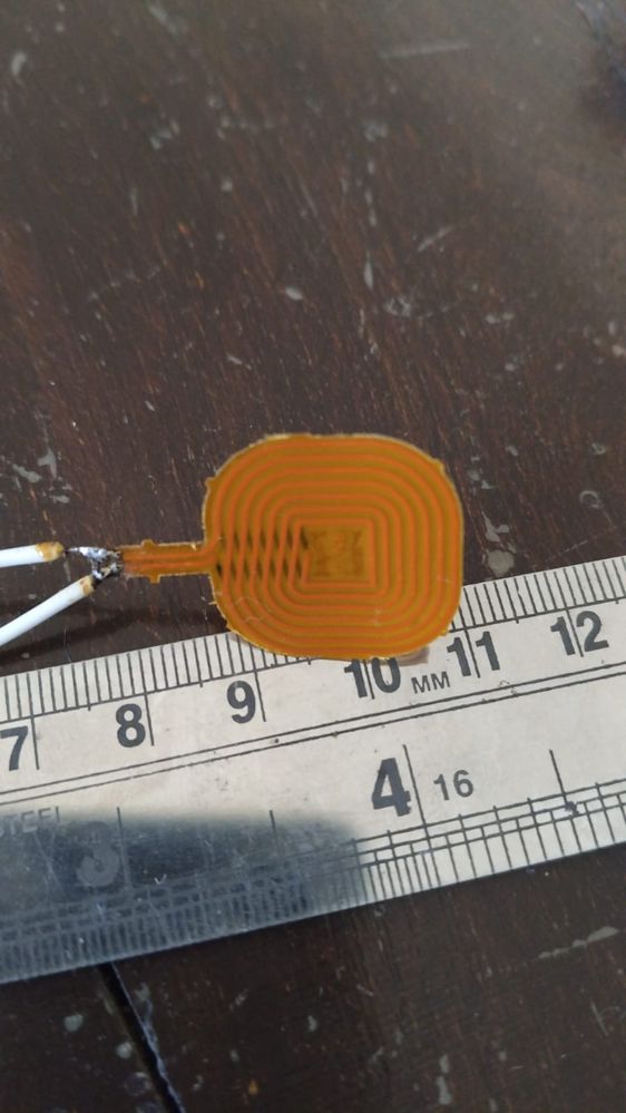

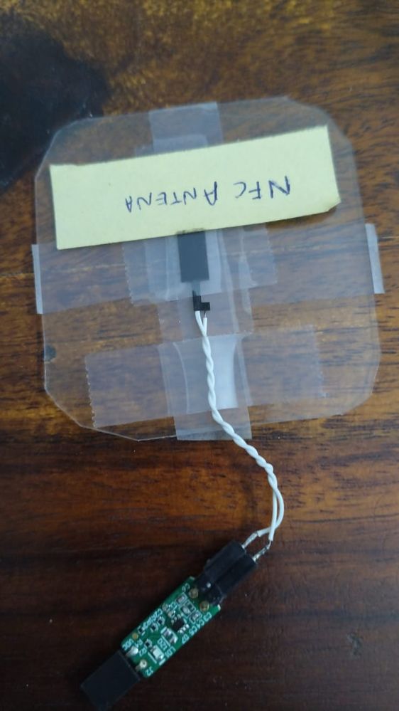

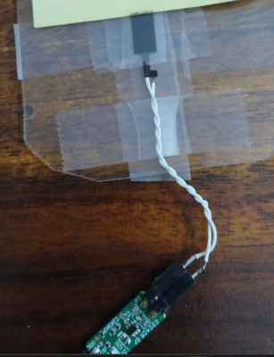

We are using the ST25DV16 as receiver and the ST25R3919B as poller. The antenna of these are fit to charge the smart ring battery of 24mAh. the antenna size are 11mm x 7mm as this fits the smart ring. We can not have a bigger antenna. Howevver we also tried to sense the tag using a bigger antenna :bigger antenna
But still the tag is not sensed.

The size of the antenna is not the only factor.
As said above, you need to check the tuning in frequency of the antenna.
The antenna inductance must be around 4.8uH so that with the 28.5pF capacitance of the ST25DV, it will have a resonant frequency around 13.56MHz.
Do you know the inductance of the antenna and the tuning frequency of the couple antenna + ST25DV ?

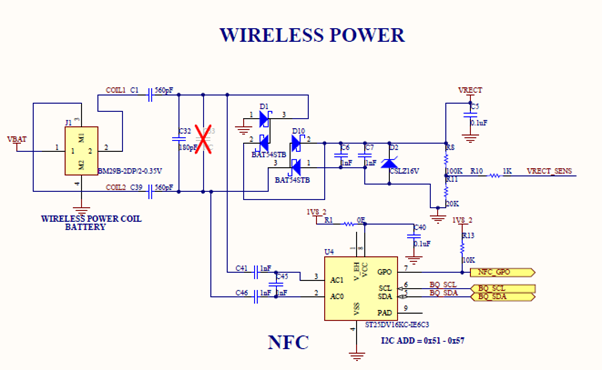

Hi, We used this to design our antenna https://eds.st.com/antenna/#/
As the antenna was small with 12mm x 7mm we could achieve only around 500nH of inductance. However we could use the two ICs (poller - ST25R39 and listener ST25DV) to charge the device. We have 24mAh battery which we charge. Can we adjust the capacitance to match the frequency?
2025-03-10 6:33 AM
Listener has a inductance of 750nH, so we made this schematics. There is an additional 180pF in parallel to the charging coil.

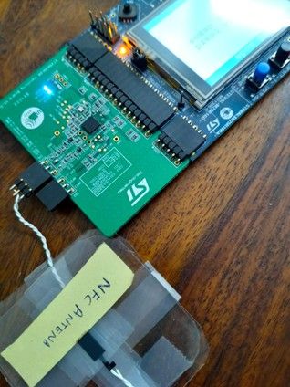

Moreover, we are not able to read ST's own supplied EVK tag. The EVK would be configured properly including the Poller and Receiver boards.
Let us know how to read the ST25DV4 tag provided by ST?
