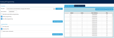

I haven't done firmware upgrade using STM32CubeProgrammer before and I don't want to mess it up. So the start address should be 0x08000000 this or something else? and also should I do a full chip erase or only selected sectors? If selected sectors, please also let me know which sectors.

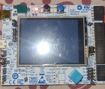

I have dropped the firmware upgrade file in the board, now it just went blank and doesn't reset as well. I have tried with STM32Cubeprogrammer as well and has the same output. What should I do next?
can you take a picture of your board and sent it to us? what is the identifier written on top right corner of the mother board (MBxxxx-x)?
rgds
BT
Its MB1396-B
Hi, nevermind this I fixed it, the problem was I uploaded the firmware upgrade demo file instead of the general ST25DV demo file, when I uploaded the general file, it started working. Thanks for helping me out. I need another help, how do I upload pics on the board without the reader board?
