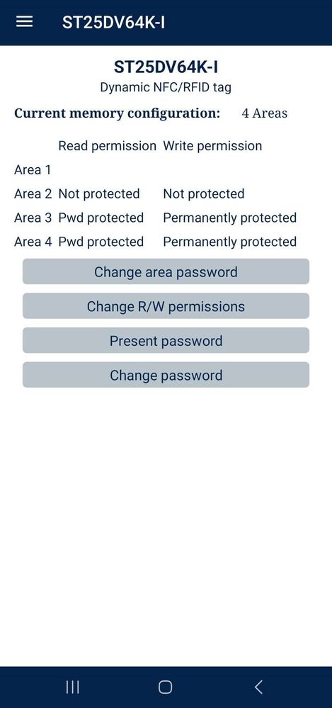

In ST25 NFC Tap application, please go to "Area Security Status" . It will show the number of areas and the Read/Write protection for each area. Can you please send us a screenshot of this screen?

The screenshot you've requested is attached below:

I can see on the picture that the status of Area 1 is blank, which is not expected. Something went wrong somewhere...
Please give the size of each area.
When using the "Dump memory to file" tool, it is by default configured for the total number of bytes of the tag (8192 in your case). This will create a failure when the application will try to read the areas protected in read by password.
So please change the field "Number of bytes". Use the size of Area 1. By this way, we will see the beginning of the memory (containing the CCFile and the NDEF present in Area 1).
