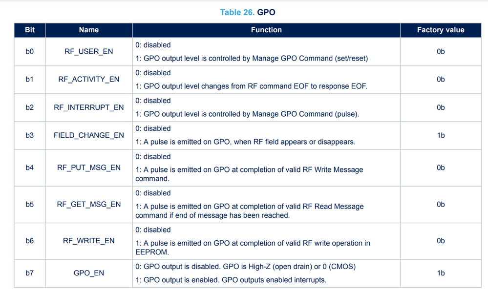

On receiving the Manage GPO command. Depending on the command argument, the ST25DV force the GPO output level if RF_USER interrupt is enabled, or send a pulse on GPO output if RF_INTERRUPT is enabled. If neither RF_USER nor RF_INTERRUPT was enabled, the command is not executed and ST25DVxxx responds an Error code “0F�? ...
here after some tests:
2023-05-10 09:45:11.358 21531-21642 Iso15693Protocol com.st.st25nfc.dbg D ==> Send custom_cmd command: 22 a9 02 09 0e 66 02 00 24 02 e0 01
2023-05-10 09:45:11.368 21531-21642 Iso15693Protocol com.st.st25nfc.dbg D Response: 00

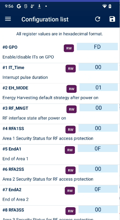

Registers:
Please check that :
bits b0 RF_USER_EN=1 and b7 GPO_EN=1
Concerning behaviors on mobiles, no ideas at this stage
Best regards, FB
