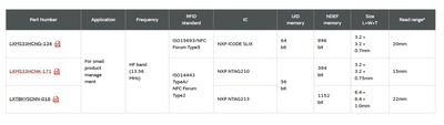

do you have any IC that can read either one of the three tags linked below?
Two of them are one frequency and the third of another frequency, we can stick to using just one frequency, 13.56MHz might be the better one.
If not, do you make any tags as small as those for which you can also provide a reader IC?
LXMS33HCNG-134-datasheet (murata.com)
LXMS33HCNK-171-datasheet (murata.com)
LXMSJZNCMD-217-datasheet (murata.com)
Thank you

Hi Ricko,
I think one of your links was incorrect:
The HF chips can be read with any reader of our ST25R reader family. Due to the small antenna of these modules the read range will likely be limited to few millimeters and maybe you want to design a reader antenna fitting these tags.
BR, Ulysses

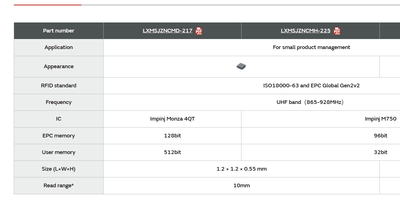

My understanding is that there are tags/systems like the UHF band (865-928 MHz - one of the links in my original post) that are very robust at reading multiple tags at the same time, much better than those at 13.56MHz.
And the main point is that that is done all in hardware which would make time to market shorter and also a much more robust system.
Do you have readers ICs for those UHF tags that can do multiple tags reading?
Thank you
2024-11-05 5:44 AM
ST does not have anymore UHF readers in its portfolio.
