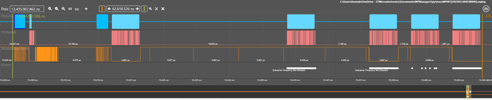

the typical NFC Forum collision resolution process includes a 1-slot Inventory followed by a 16-slot Inventory in case of collision has been detected during the 1-slot Inventory. Further 16-slot Inventory commands may follow when further collisions are detected.
Here a typical sequence with 5 tags in the field of a ST25R3916B reader:
In dark blue, the Inventory Requests and in light blue the Inventory Responses. The 1st command is a 1-slot Inventory followed by collisions (5 tags replying). The 2nd command is a 16-slot Inventory followed by 5 answers in slots 1, 5, 7, 8 and 9 without collision.
So basically the inventory speed is not reader dependent. Without collision during the 16-slot Inventory, one can expect to detect 5 tags in ~90ms if one of the tags replies in the last slot. In case of collision, further inventory commands are needed.
