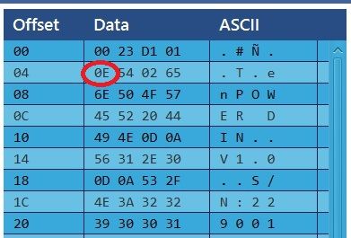

2022-07-20 6:17 AM
Hi Fabrice,
the NDEF is malformed. The text record has an incorrect payload length (0E):
The correct payload length for the Text record should be 1F:
Rgds
BT

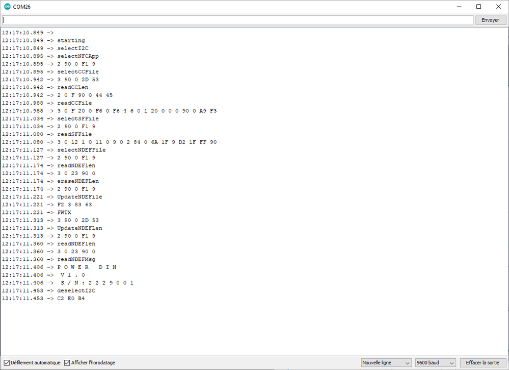

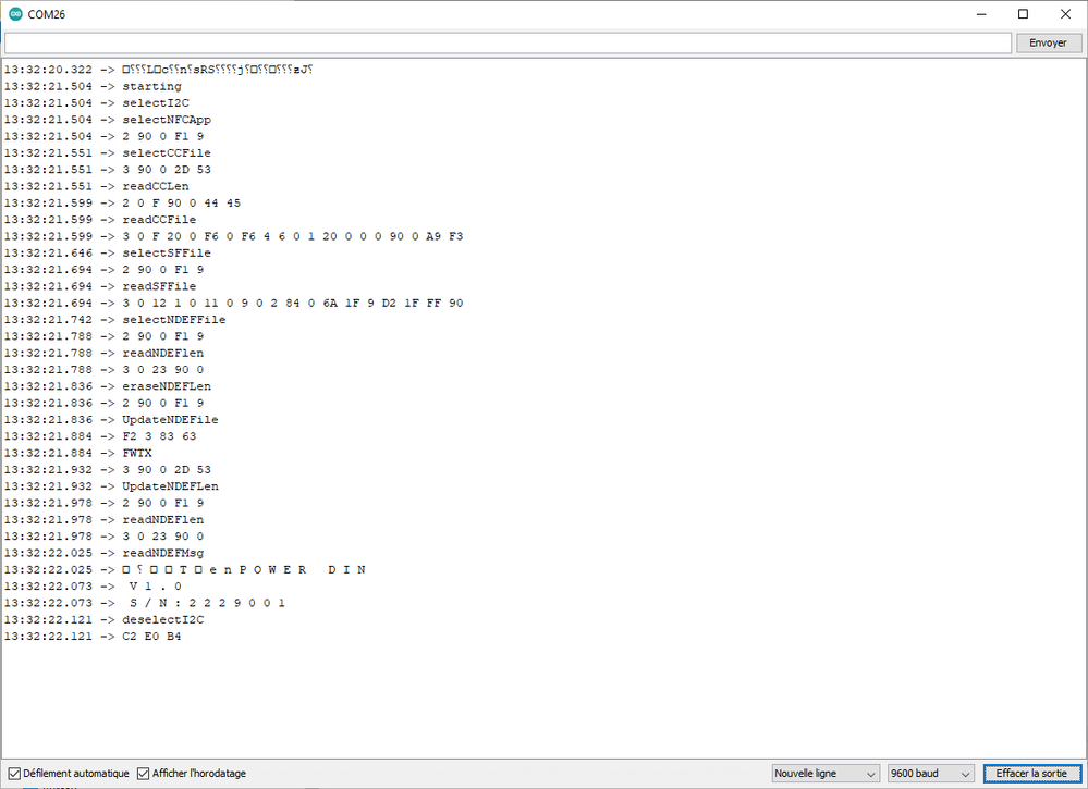

/* END OF FILE */Hi,
Thank you for your quick answer.
I've tried with ST25 NFC tap App.
When the dev board is disconnected (without any supplies), the app can read the tag, but there is nothing in the NDEF tab (I cannot see my recorded text), but I've put in the memory the right bytes (0xD1,0x01...)When the dev board is connected to my ESP (VCC supply by it), nothing happens, the dev board is not detected.
If needed, please find above my code.

2022-07-20 6:17 AM
Hi Fabrice,
Rgds
BT

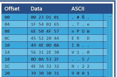

2022-07-20 6:34 AM
Thank you for your answer, it works. Effectively this byte correspond to the size of payload, and I forget to change it (I kept the size of my previous test).
