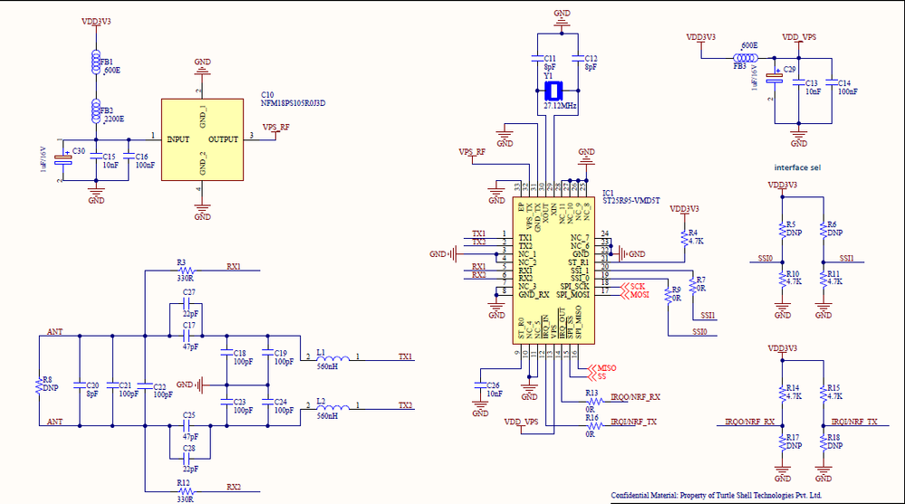

Can you share the schematics of your custom board so that I can review them?

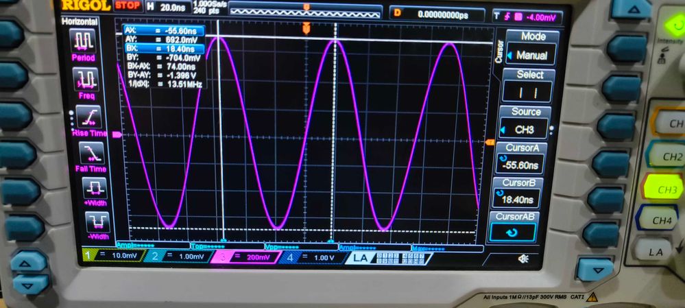

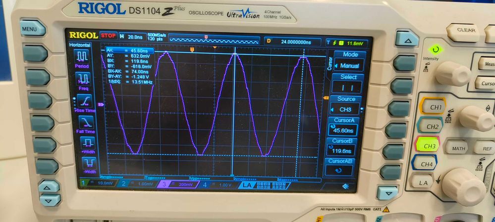

We tried probing the RF field and were able to pickup the 13.56MHz carrier and at both the sites the we observe no difference. Also dc level at ST_R0 is same that is 7.8V at both the sites. We also probed the 5V output from the adapter and found the voltage is stable and ripple is around 30mVpp.

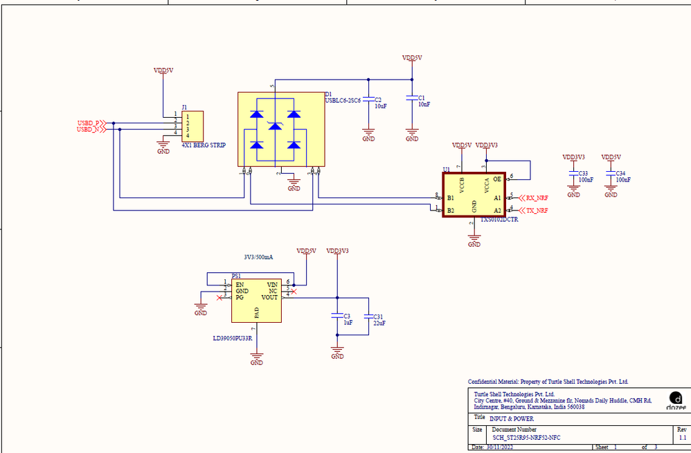

Sharing the schematics for your reference

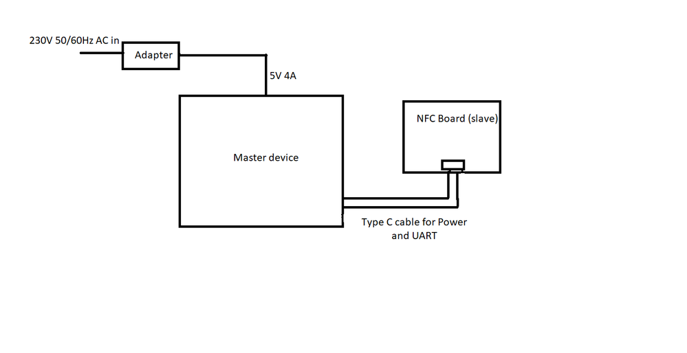

Can you please share reference schematics for the same?
Where exactly should we add the 2nd order LPF?
FYI we are into production now and we will not be able to change the design. Can you suggest any other alternatives to minimize this issue?
Can we try by adding ferrite beads/chokes on the power line to minimize this issue?
Attaching a rough block diagram for your reference, Please suggest accordingly
