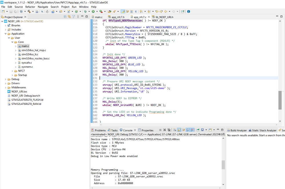

I have downloaded 'en.x-cube-nfc7' according to the instructions,but the ST25 tap app of my phone did not read the "www.st.com/st25-demo" link. What should I do?

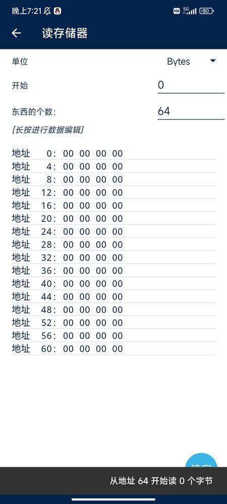

I have learnt about ST25 and used above codes,But I failed to make the web link in the code appear on the phone screen to read out,what is more,st25 shows that memory is empty.

I can see what you mean and I can write an NDEF into tag by ST25 Tag. But I want write NDEF by a MCU connected to a ST25 Dynamic tag by I2C,so I used above codes to write NDEF and read by ST25 Tap. What should I do?
