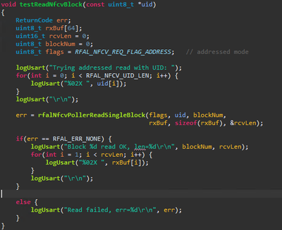

I am using STEVAL 25R200 board to read/write NFC tags. Currently, I am using NFC V type tag which is getting detedted by the EVAL GUI software as well as by the code I implemented using RFAL layer functions through Cube IDE.

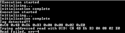

My tag UID as seen in the EVAL GUI is e002080ab3e64bc8 which matches what I am getting after rfalNfcGetActiveDevice() function executes. I have the following testReadNfcBlock() function based on the rfalNfcvPollerReadSingleBlock() function.
I am calling this function with input parameter as the dev->nfcid (that I get from the rfalNfcGetActiveDevice) inside the while loop. The read fails with a timeout error code 4. I even tried reversing the UID just to confirm that the UID handling error is not the problem.

Hi Atomic1,
I think you are missing proper flags. Please use RFAL_NFCV_REQ_FLAG_DEFAULT for the lower layer - otherwise the response will come at wrong data rate. The ADDRESS flag will be adapted anyhow if you provide a UID.
BR, Ulysses
