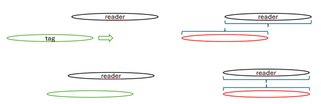

There's actually 3 dead spots :
- 2 when the middle of the tag is in front of a coil of the reader (which correspond to "the two antennas are overlapping in a way that the inside and outside flux are equally strong and cancel out each other").
- The last one is when the tag and reader's coils are in front of each other. The reader's antenna is sightly bigger.
The reader to tag height is around 5mm. This is simetrical left and right of the reader.

Hi StuN1,
IMO the two dead spots cannot be avoided when having only these two antennas.
The other dead spot could be an effect of too strong coupling and de-tuning. Here I guess it would be worth to investigate based on VNA, field sniffs, antenna voltages on tag and reader, etc.
