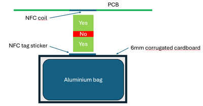

The application is quite simple: An NFC tag (sticker) identifies a consumable in a machine.
The PCB/NFC reads the tag to check simple data.
The distance from the NFC coil to the tag is fixed in the machine, 15mm +/- 5mm.
In free air, I have a reading distance of appr. 50 mm, very stable. Great!
My problem is in the machine:
The NFC tag is mounted on the outside of a bag-in-box system.
The bag is coated with aluminium. Not good, I know...
6 mm cardboard makes a distance to the aluminium bag, so that we have a max reading distance of app 30mm.
This is actually OK.
BUT: There is a "dead spot" somewhere in the middle of the reading distance.
The spot is like 1-2 mm wide. Very little difference can make it work as a charm, or just fail.
See below.
I don't see this dead gap when the tag is not on the bag, so the problem is close related to the aluminium bag under the tag.

From your sketch, i see that there should be still some distance between aluminium bag and tag.

Are you referring here to x-y placement or the z distance? In your drawing, reader and tag antenna are the same size. Typically the reader antenna is bigger (e.g. 1.5x) than the tag antenna. This ensures that the tag antenna integrates only the magnetic field inside the antenna.
Looking at the opposite scenario - the tag antenna is bigger than the reader antenna - the tag would integrate the inner and outer magnetic field from the reader. In this case the outer magnetic field would cancel parts of the inner magnetic field. Metal (or aluminium) environment could weaken the magnetic field. The remaining field (=induced voltage) could be below the tags activation threshold. (bullet #1 from the list above).

OK vs FAIL distance (dead spot area):
In my tests, I continously read the tag. I then lower the PCB slooooooowly towards the tag, and then I can see when the reading fails.
When it fails, I can fix the PCB, and it will just keep failing. If I move it 1 mm up, it starts reading with no errors at all.
The dead spot area is a few millimeters.

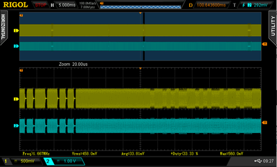

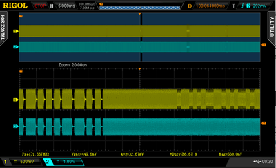

2024-05-16 2:56 AM
Hi Travis
We have now made some tests, with spy coils.
Signal from spy coils are sampled, and distance from NFC coil to NFC tag is slowly changed, until communication stops.
There is not much difference to see: The signal at the coil is maybe 15-20% higher amplitude.
From the screenshots, it looks like the tag responds to the TX signal from the ST25, but the communication is not accepted/failed.
Can you conclude anything from these screenshots?
The first one is with OK communication, the second one fails:
Yellow = Spy coil close to tag
Blue = Spy coil close to coil
2024-05-16 3:32 AM
Hello Kaare,
from the scope shots i cannot see anything being obviously wrong.
The amplitude on the tag spy coil is reducing a bit, but the tag is still responding => sufficient power.

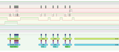

2024-05-16 10:30 PM
Hi Travis
We have made SPI traces in both situations. At first glance, there are major differences.
Can you read .sr / .pvs file formats?
We use PulseView, which is free to use, and works great.
Or would you like me to write down the commands/SPI communication in plain text?
Screenshot from PulseView:

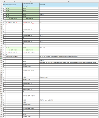

2024-05-17 1:44 AM
Hi again
I have tried to zoom in on the SPI traces, but there is A LOT of communication going on...
To simplify, I have tried to focus on the SPI FIFO commands, and compare the sequence when communication is OK, to the situation where we are in the blind spot, and detecting tag fails:
See the screenshot below (I hope you can read it).
NOTE: I have not looked deep int the user manual, to check all commands.
For now, I have just managed to find some differences in the SPI communication.
Some comments on my observations:
- The first few FIFO commands looks the same (green)
- Then, of some reason, the the W+R in line 10+11 is not exactly the same
- After this, the OK scenario ends with som commands, and then repeats later. But the FAIL scenario tries 4 times with no success.
- After 4 tries, the FAIL scenario seems to start again, but it does not continue the 4 tries as earlier.
I will try to investigate more, but there is so many commands and possible analog tuning which would take me forever to fully understand. So I hope you Experts can help :)
