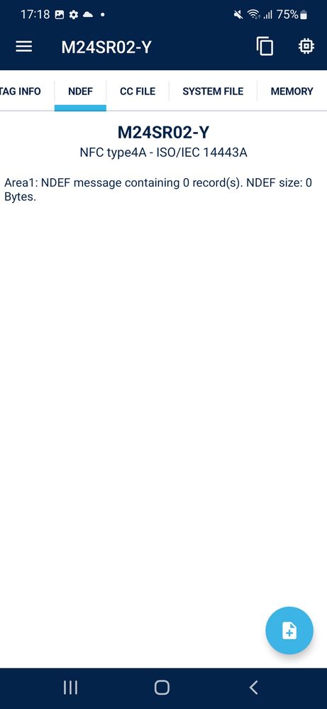

2022-09-14 9:24 AM
you probably try to write a bluetooth record with mine type = application/vnd.bluetooth.ep.oob but your buffer seems corrupted with a 00 every 2 bytes (it looks like a Double Byte Char String issue). So the NDEF message inside the tag memory is inconsistent. Using the ST25 NFC Tap, you can go to the MEMORY tab and see that the content of the NDEF is incorrect.

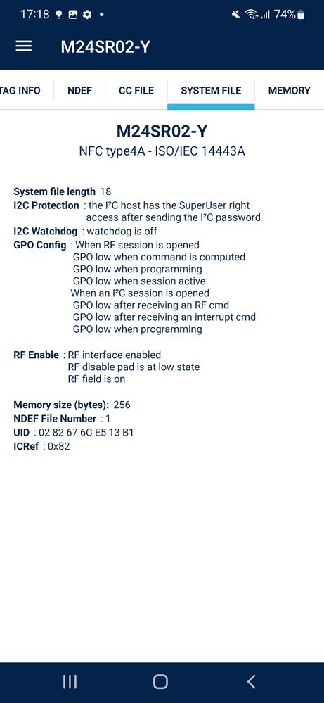

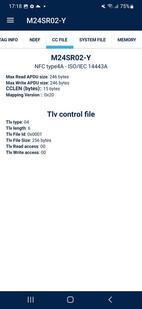

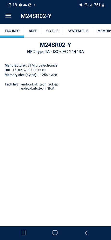

2022-09-14 8:37 AM
This are the informations the app gets from the tag. To close the I2C session I just turn off the supply voltage of the tag.
The NDEF file seems to be empty, but during communication via I2C I get "command completed as response. Here is the whole writing process:

2022-09-15 4:04 AM
Oh I see. I fixed the bug in my code and it is working now. Thank you very much for your help.
