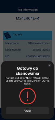

Hello, I build a business card with the M24LR64E-RMN tag.
When using NFC Tap application on Android everything works perfectly. I'm able to write and read the NFC tag.
However, when using with iPhone 12 (IOS 17.7.1) - while reading a tag I'm getting the following fault. I'm not able to write NDEF commands and neither can I read the tag (When with Android everything works fine).
Have any of you face similar issues?

Hi Mkoza,
All my apologizes, but M24LR64 is not supported by iOS CoreNFC.
I invite you to have a look on thread https://community.st.com/t5/st25-nfc-rfid-tags-and-readers/nfc-memory-m24lr-64-er/td-p/647758
hope it clarifies.
Br,
