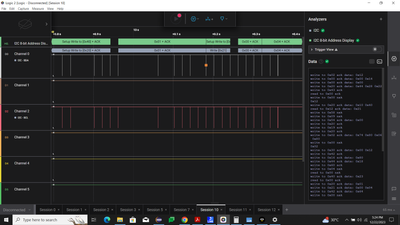

So in logic analyzer I am getting ack from device and also its showing writing random data in some random address but if we try to read memory using the st nfc app nothing is there .So i am sharing some logic analyzers pic with you guys if you can suggest about what can be the problem it will be helpful--
2023-12-22 6:54 AM
Sorry, but the logic analyzer traces don't help as we can't see the I2C frame at bits or even Byte level: "write to 0x02 ack data:0x12". What does it mean ? Do you write to I2C slave address 0x02? This is not ST25DV64K address...

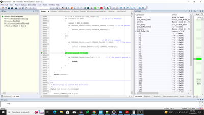

Again thank you for your speedy response but as you can see in the above code both for sending memory address and data I have written i2c send byte function where I have put slave address as 0xA6 so is it doesn't matter for that left shift .
BOOL_TYPE I2C_SendByte(I2C_ENUM_TYPE i2c, uint8 byte) {
uint8 buffer[1];
buffer[0] = byte;
I2c__Write(i2c, 0xA6, buffer, 1);
another way I tried to write on tag ---
any other changes you think I need to make to write on the tag
2024-01-08 2:48 AM
Hi PoolBear,
You were mentioning in you first post that you received an ACK at each write, but in you screenshot it seems to be an error response (not easy to read the answer). Does this response error is due to Debugger stop or sent when in run mode too.
If you could capture with the logic analyzer a single write sequence and zoom in to see the SDA/SCL bits to see in more detail what is happening.
