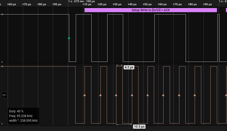

Here is the actual I2C signals... again this is the working signals. running at 100kHz.

Here is the I2C signal.
Closer look at the clock.

I2C is a quiet simple system and from the other post about this topic, I understood that you already checked the bus and pulls-up resistors. So I think I2C will have less chances to be the root cause. To be sure, the only way would be to put an oscilloscope on SDA/SCL lines and check if the transaction is OK where you read garbage bytes (you can trust an oscilloscope much more than a logic analyzer). With a scope you can precisely check that the timings and the voltage levels are good.

The simplest to check is I2C. Have you been able to connect an oscilloscope to the I2C bus to see what is really happening when wrong data is read ?
