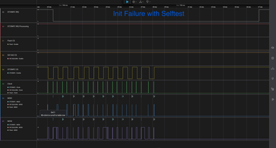

I have enabled the self test and it does fail. Attached the transactions and don't see the interrupt.

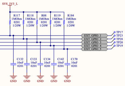

I have the GPIO interrupt initialized and enabled for positive edge properly and works if I simulate the GPIO pin. But don't see the interrupt from STEVAL-ST25R3916B reader expansion board.
We have the external pullup on this IRQ GPIO, I have it initialized as pulldown, but goes high as soon as it is connected to ST25R3916B and goes and stays low for the entire initialization.
Do you see any issue with this pullup? What should be the GPIO configuration for this IRQ?

having an external pull-up + internal pull-down is for sure not optimal. Also the digital Saleae traces will not show you the truth here. IRQ should only have a pull-down. ST25R3916B will drive it to VDD as long as interrupt condition persists.
Typically the IRQ pin is only for very short whiles (tens of us) high before the ISR kicks in, reads the interrupt status and thus clears the line again.
Having long high times on IRQ is an indication of issues - most likely in SW.
BR, Ulysses

please feel free to also share directly the Saleae traces, they typically offer a lot more information (timings, IRQ state, etc.).
I the transactions I still find a suspicious sequence:
DSTS 00007809 spi.c 712 Device: NFC, Tx Data:1681
DSTS 00007809 spi.c 756 Device: NFC, Rx Data:0078

So I think still your ISR not correctly operating.

Here is the saleae trace, Not able to upload .sal file hope .csv works for you.
Let me know if you find something. I have a worker thread processing the ISR as in /ST25NFC_Embedded_Lib_ST25R3916(B)_1.7.0/Projects/STM32L476RG-Nucleo/Applications/Common/Src/demo_edta.c example. I picked this as I eventually need to exchange T4 data. Let me know if you have any recommendations of simpler examples I can try if the issue is a delay with isr processing.
