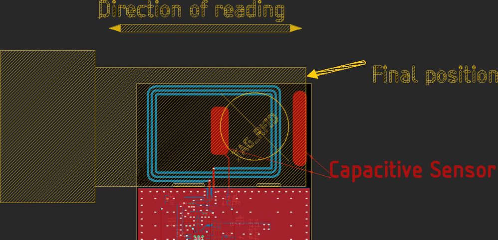

Find attached an imagem of my application, where in yellow you can see the badge with the TagRFID

Hi TDumb.1,
yes capacitive sensor could be used for such. You just need to set a new reference value cm_ref of the measured capacitance with the card in position and define a proper delta.
The other alternative would be to perform NFC-based presence check to see when the communication breaks by the card having exited the slot.
Best Regards, Ulysses
2021-12-22 9:48 AM
Hi Ulysses,
I am really impressed with your responsiveness. I really appreciate that!
Unfortunately, I cannot use the NFC-based presence check as I need to detect the moment as soon as the card started to be removed, and then perform a write cycle in the tag (with the updated consumption value) before it is out of the NFC range. I chose this procedure to avoid writing many times on the tag and extend the lifetime of the EEPROM of the tag.
So, one possible solution would be:
After the reader ST25R3916 wakes up and detects the card, I will set the new delta (cm_ref). So, I'll put it back to wake-up mode to detect the new variation(when the card started being removed) and generate a new IRQ to the MCU when I will able to send the write cycle and update it before the card is out of range of the reader.
Please, correct me if I am wrong.
