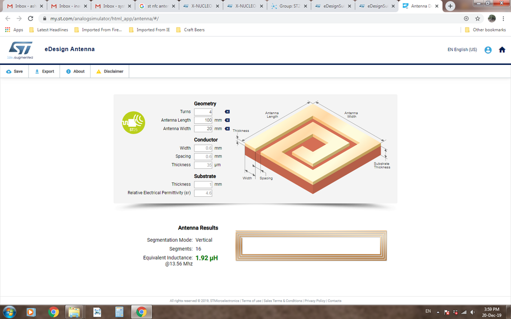

I have X-NUCLEO-NFC01A1 Board with M24SR chip. I am Currently Developing a Product using it. For my application i want the antenna to be in Flexible PCB with 100mmx20mm outer dimension.
For this I am using eDesignSuite NFC Antenna Design tool. i wanted to know how to calculate the antenna matching circuit for this antenna.
also i wanted to know the inductance and and antenna parameters of the antenna present on the X-NUCLEO-NFC01A1 Board.

M24SR family has a input tuning capacitance of 27.5pF. As a résult, target inductance of antenna for a resonant frequency of 14-14.4MHz (recommended for ISO14443 product, see AN4409 Using the same antenna for M24LRXXE-R and M24SRXX-Y Dual Interface EEPROM families).
between In Nucleo-NFC01A schematic, there are capacitors (C2, C6,C7, C8 and C9):
A double layer antenna as well as using trimming caps between AC0 (respect. AC1) ang GND are not necessary. for your specific need, you can design a signle layer coil 100x20mm with 4.7µH max inductance.
You could target 4.5µH for instance and adjust tuning frequency with parallel tuning cap as C2. Based on Edesign Suite, it could be:
Feel to tell us if you need more,
