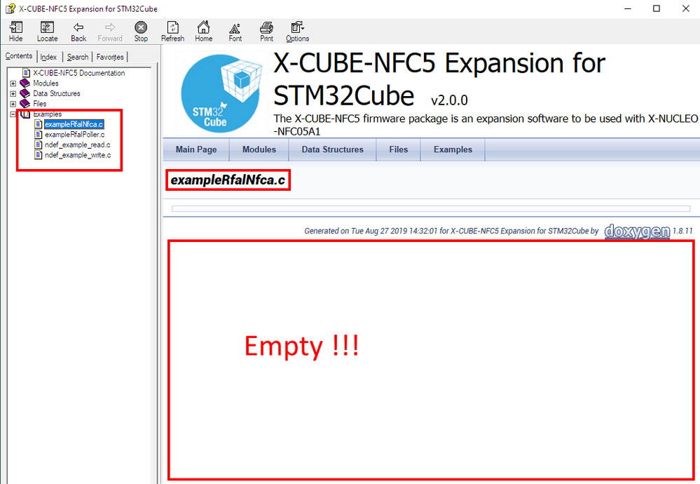

I am not able to find proper examples and/or documentation on how to add RAFL to my project.
Looking into the rfal.chm file in RFAL there is an example but it does not work for me ?
When I am looking in X-CUBE-NFC5.chm there should 4 examples but its empty.
The documentation for how to add it to a project is limited.

thanks for having highlighted the issue with X-CUBE-NFC5.chm file. I will report this issue internally. As a workaround, the 4 examples can be found in rfal.chm and ndef.chm files.

2020-09-01 9:10 AM
which version of X-CUBE-NFC5 do you have? On my side, I have the V2.0.0 and X-CUBE-NFC5.chm provides 2 examples which are not empty (see attached screen shot)

2020-09-02 12:07 AM
Dear Brian,
I was referring to X-CUBE-NFC5 Expansion for STM32Cube v2.0.0
In the RFAL.chm file there are two examples as you noted above.
In rfal.chm document (RF Abstraction Layer) there is a flow describing how to modify the platform.h file.
