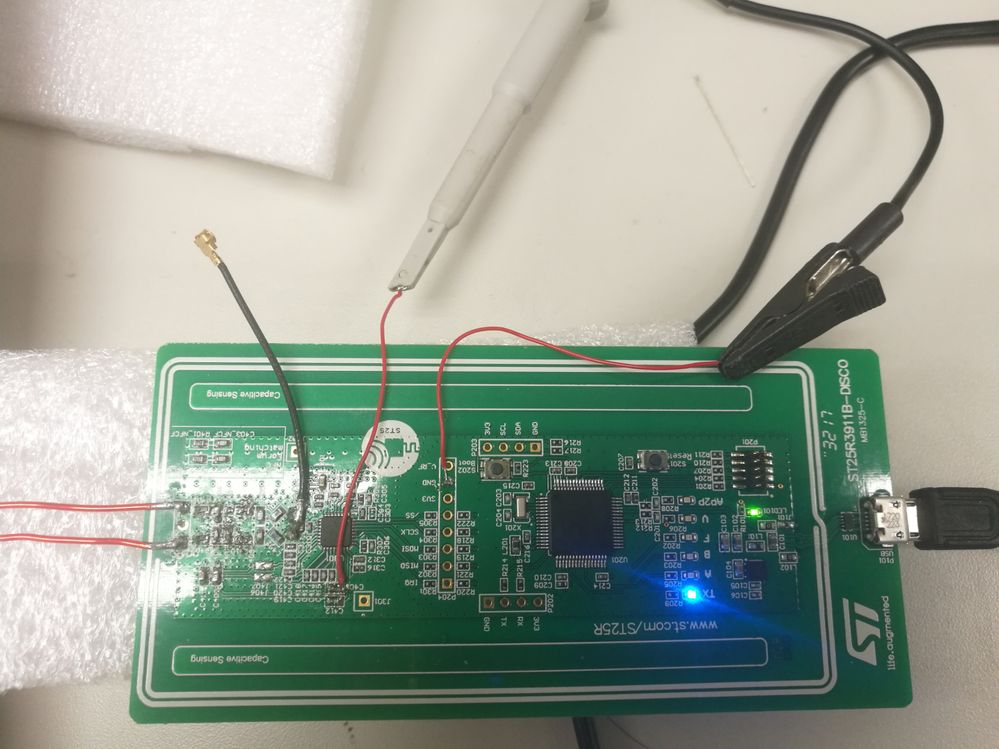

Internal receiver signals:
You need to connect to P301 (CSO) and P302 (CSI) on the bottom side of the board. There is a footprint for UFL connectors foreseen where a UFL to BNC or SMA cable could be plugged. You can also directly solder a cable to the pads. To capture a good signal, i recommend to remove / cut the traces leading to the capacitive patches (they could pick up some field).
You should then use a high impedance probe to feed the signals into the oscilloscope.
Referring to chapter "1.2.15 Test access" of the datasheet DS11793 - Rev 5:
By setting the registers as described in this section, you can e.g. output the analog signal of the AM channel and see how the digitizer decodes it.
several other combinations are possible as mentioned in Table 13.

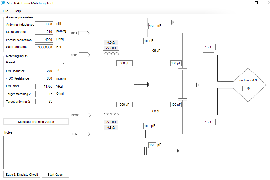

Hi Travis,
Thanks a lot for your reply. This is some inputs and test set up:
Could you point out whether there is any mistake above?

all your inputs in theST25R Antenna Matching Tool look valid.

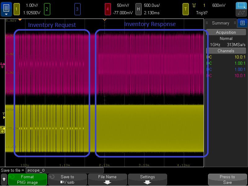

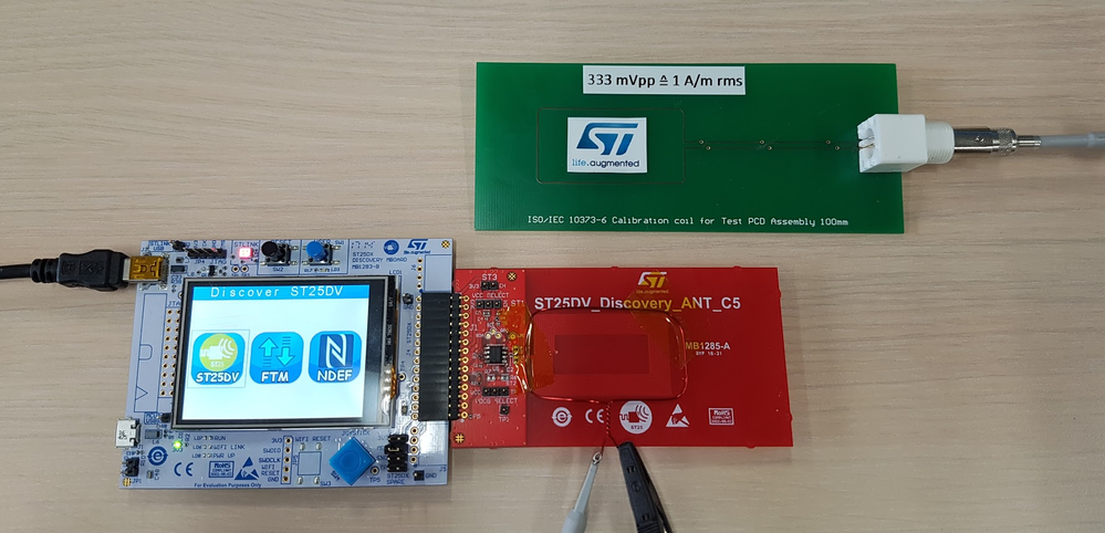

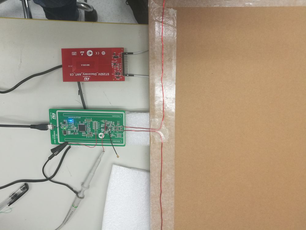

I usually use two pick up coils. One is close to the reader and used for triggering my scope, the second one is used to pick up the cards response.
You can either use a self made pick up coil (red wire tapped to the ST25DV_Discovery_ANT_C5 PCB directly) or an ISO Calibration coil (green PCB).
Both methods should use a high impedance probe to connect to the scope.

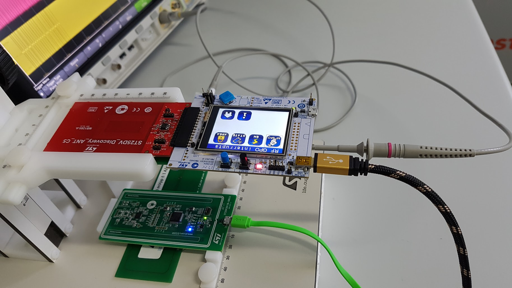

This is my lab setup for such investigations:
The yellow channel is recorded via the pick up coil close to the ST25R3911B-DISCO board. You can clearly see the inventory request command sent by the reader. The inventory response is already very small and cannot be seen with bare eye anymore. Still the reader can decode the response.
The red channel shows the signal recorded very closely to the tag. We can therefore clearly see the request sent by the reader and also the response sent by the ST25DV_Discovery_ANT_C5 tag. It shows the H-Field close to the tag.
If you now increase the distance between reader and tag, either the reader stops seeing the tag (sensitivity limited) or the tag stops responding (power limited).

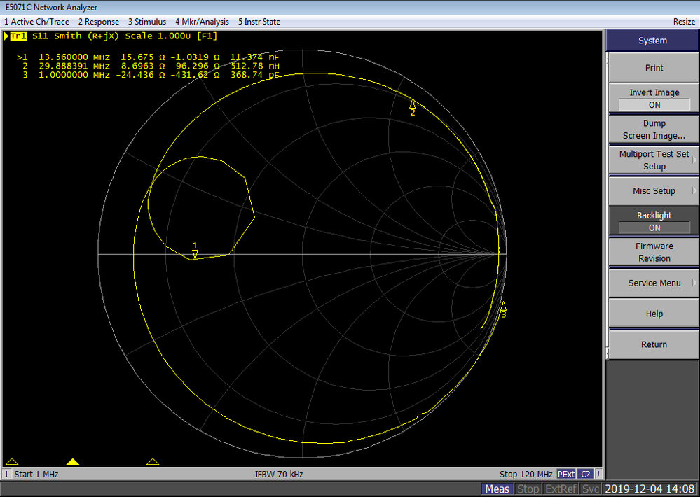

"And is it the impedance more close to pure resistance, the performance will become better?"
What is your current matching impedance? can you add a VNA smith plot?

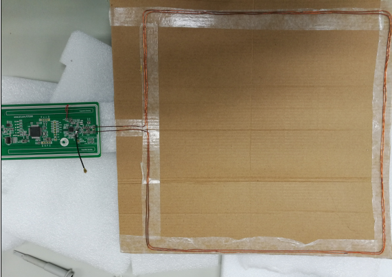

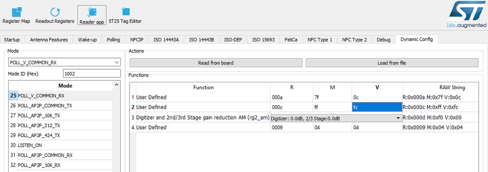

I have tried the smaller coil 25*25cm(2 turns) with the smith chart and change the received settings as below:
Now the maximum reading distance is 25cm, do you have any other suggestions for improve the reading distance, such as add power... or this is the limited distance for my case, actually the tag coil size can't be increased more...
Another question is the coaxial cable connected to VNA, did i need disconnect the circuit behind?
Thanks.

Your matching and VNA measurement looks perfect.

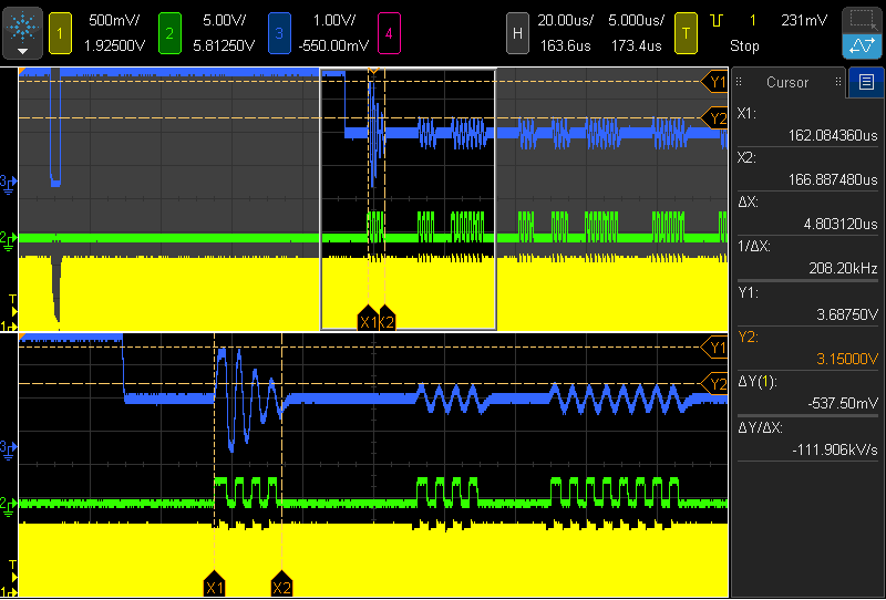

Below you can see a Type A response showing:
Yellow: H-Field
Blue: Analog output of AM channel (before digitizer)
Green: Digital output of AM channel (after digitizer)
The screenshot shows a quite strong signal. After the first sub carrier pulses the AGC reduced the signal to a optimum level.
You can now alter filter and gain settings and instantly see their impact.
