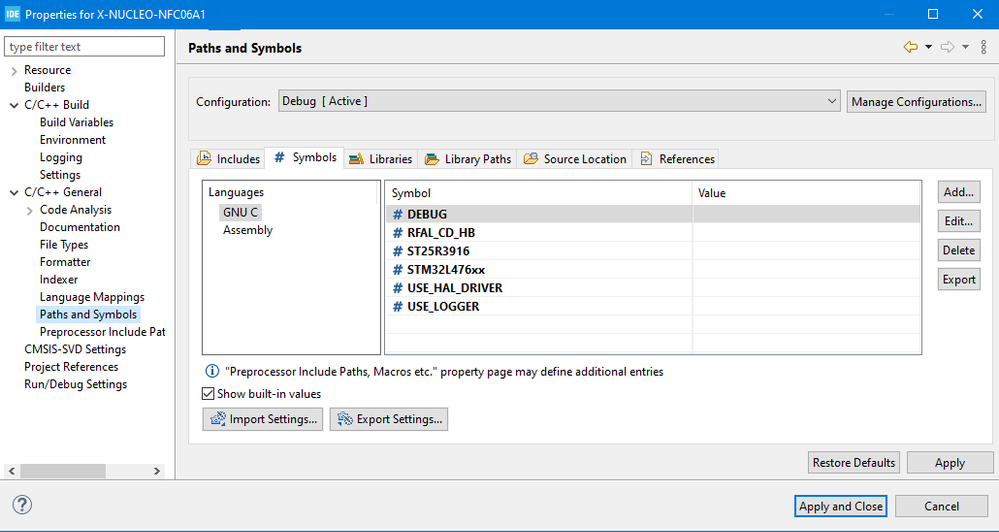

wells as the line tells you: You need to define ST25R3916 (when using NFC06) in the global properties. Likely something like:
Best Regards, Ulysses

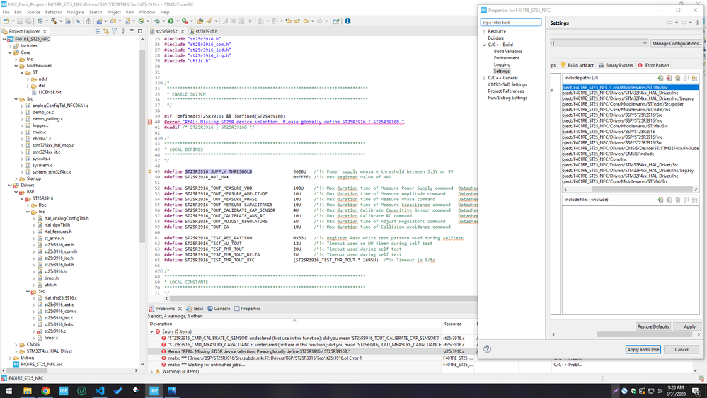

Hi Ulrich,
I've already tried exactly the same way but failed. I am attaching a screenshot of my project errors and path below.

2023-05-30 11:52 PM - edited 2023-11-20 4:22 AM
