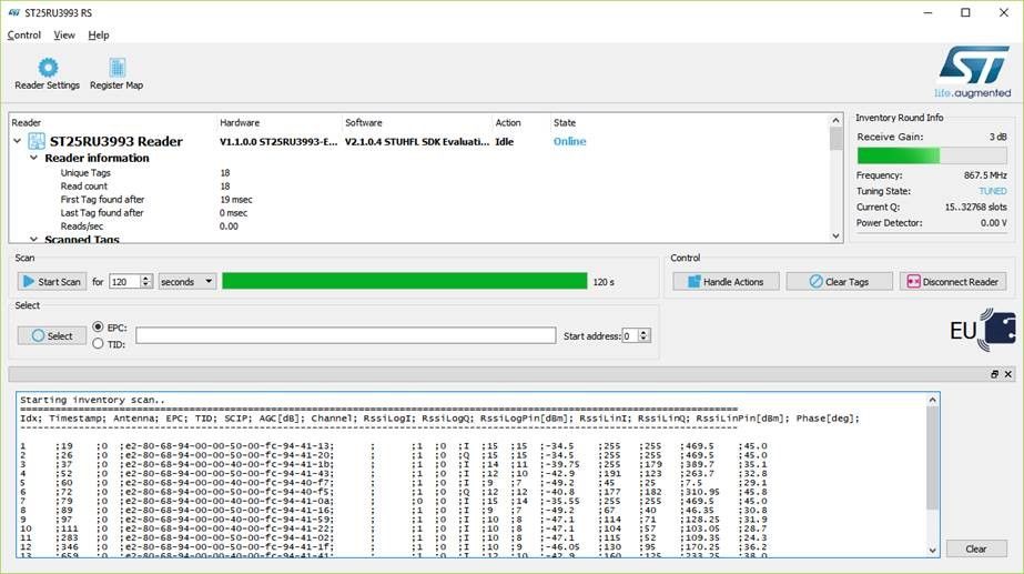

Hello Uyalc,
There is indeed a feature in the GUI that allows such tag list.
In the GUI menu enable the "Trace Browser" feature (menu -> View -> Trace Browser), there you see all found TAG information during scan (cf attached) in a csv format.
This can be easily copied and paste to a .txt or .csv file.
