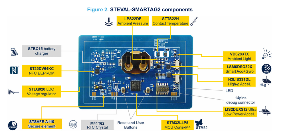

However the SMD Components for STBC15 battery charger, haven't been attached as seen from the following photo:

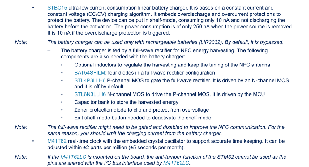

Here is an Snapshot from the User Manual:
Based on this STBC15QTR, BAT54SFILM, STL4P3LLH6, STL6N3LLH6 and some other components should be added. However I've little problem with attaching these SMD components. STBC15QTR can't be soldered with a standard soldering iron, as the connection pads are entirely underneath the chip.
In the other hand using hot bed or reflow oven doesn't make sense, as they would damage other parts of Smartag2 (for example debuging pins)
I unfortunatly couldn't find any instructions for attaching theese SMD components. Now I am wondering What is ST:s official suggestion on, how these components should be attached? :)

I confirm that the STBC15QTR cannot be soldered with a standard soldering iron, for this type of device, one of the following methods should be used:
Both methods allow proper soldering of the bottom pads, which is not possible with a traditional tip soldering iron.
