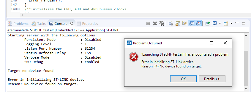

ok right, i get it, can i really use atollic IDE to debug EVAL-ST95HF board? because i created a new project from MCU (STM32F103RGTx) in CubeMX and then i built project into Atollic, but when debugging i get this message error
and when I use STM32 ST-Link Utility or STM32cubeProgrammer, i Successfully to download program but i can't debugg step by step. my goal is to build et debugg step by step to figure out how code is made, do you have any idea how to realize that or which tools i have to use without using full keil uvision5 version?

which probe do you use (i.e. a ST-LINK/V2 probe with the 20 pins cable or the ST link module from a Nucleo-64 with wrapping)? Is the SWD NRST pin properly connected?
Can you check that SWD option is selected in your debug configuration?
Can you try to perform an Erase Chip with ST-LINK utility before lauching Atollic TrueSTUDIO?

i'm using ST-Link/V2 probe, i managed to debug my new project with CubeMX, i had forgotten setting SYS Mode and configuration ( set Debug Mode to serial wire) when i generated the project. then i unzipped the EVAL-ST95HF project from ST website and imported it into atollic. When i build, i have multiple errors such as:
