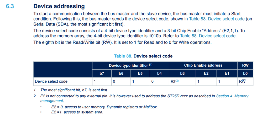

Could you please check the datasheet : Datasheet - ST25DV04K ST25DV16K ST25DV64K - Dynamic NFC/RFID tag IC with 4-, 16-, or 64-Kbit EEPROM, and fast transfer mode capability
In section 6.3. : The ST25DV is one device but responds to THREE I2C addresses: 0x2D, 0x53 (user memory) and 0x57 (system memory)
Hope I helped you!

I recommend you use :
HAL_I2C_Mem_Write (I2C_HandleTypeDef * hi2c, uint16_t DevAddress, uint16_t MemAddress, uint16_t MemAddSize, uint8_t * pData, uint16_t Size, uint32_t Timeout);
HAL_I2C_Mem_Read_IT(I2C_HandleTypeDef *hi2c, uint16_t DevAddress, uint16_t MemAddress, uint16_t MemAddSize, uint8_t *pData, uint16_t Size)Foued
