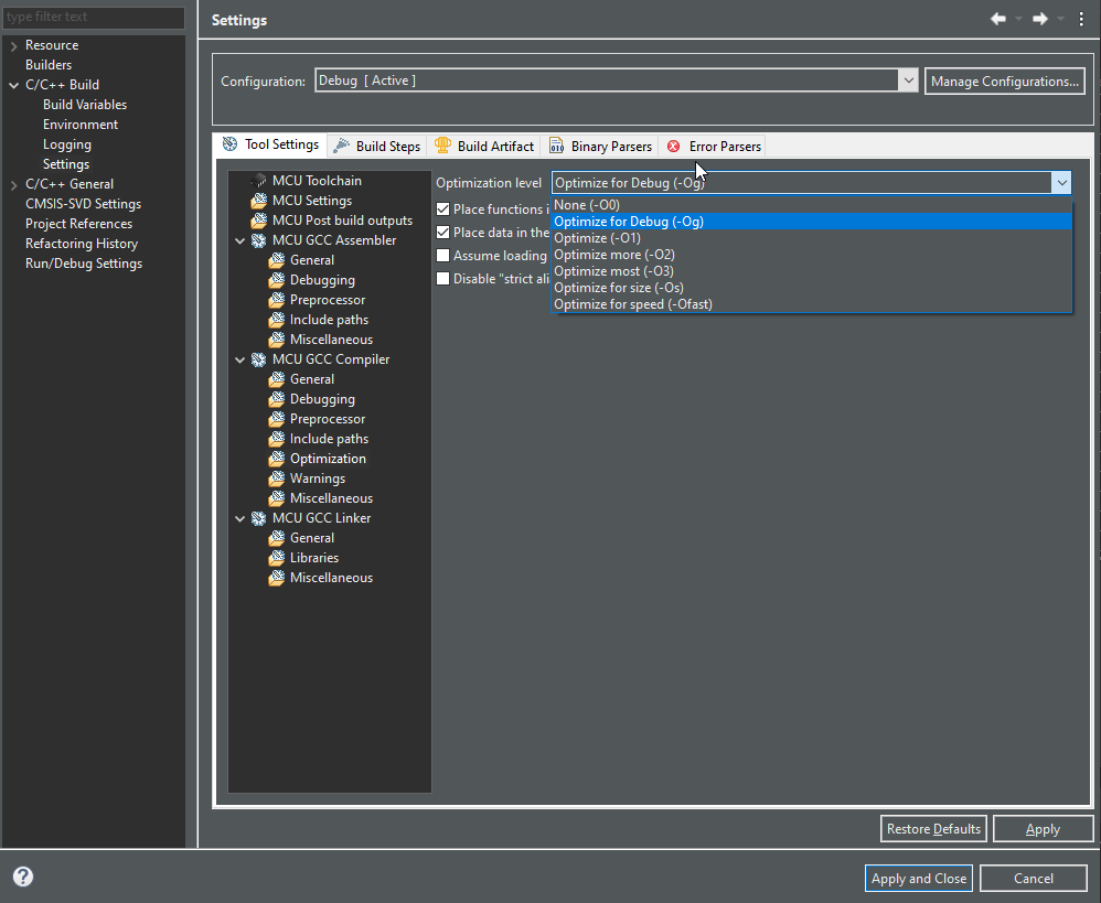

I'm using ST25R3911B-DISCO for reading tags, but I'm interested in optimizing my code.
When a search how optimizing codes in C, I see people using #pragma but I don't have the answer in my code after in the proprieties in STMcubeIDE I will go to optimization, but just optimization for debugging works for me. Is It possible to use optimize the speed in that code?

I'm using the ST25R3911-DISCO to reading a tag, and I search for ways of optimizing my code for one code more fast and small.
when I say " just optimization for debugging works for me " this phrase means when I use the option "Optimize for Debug" my code has better performance and keep works but when to try to use other option like "Optimize(-01)", "Optimize more(-02)", "Optimize most(-03)", "Optimize for size(-0s)" and "Optimized for speed(-0fast)" my code stop to the worker in that case stop to read tags.
