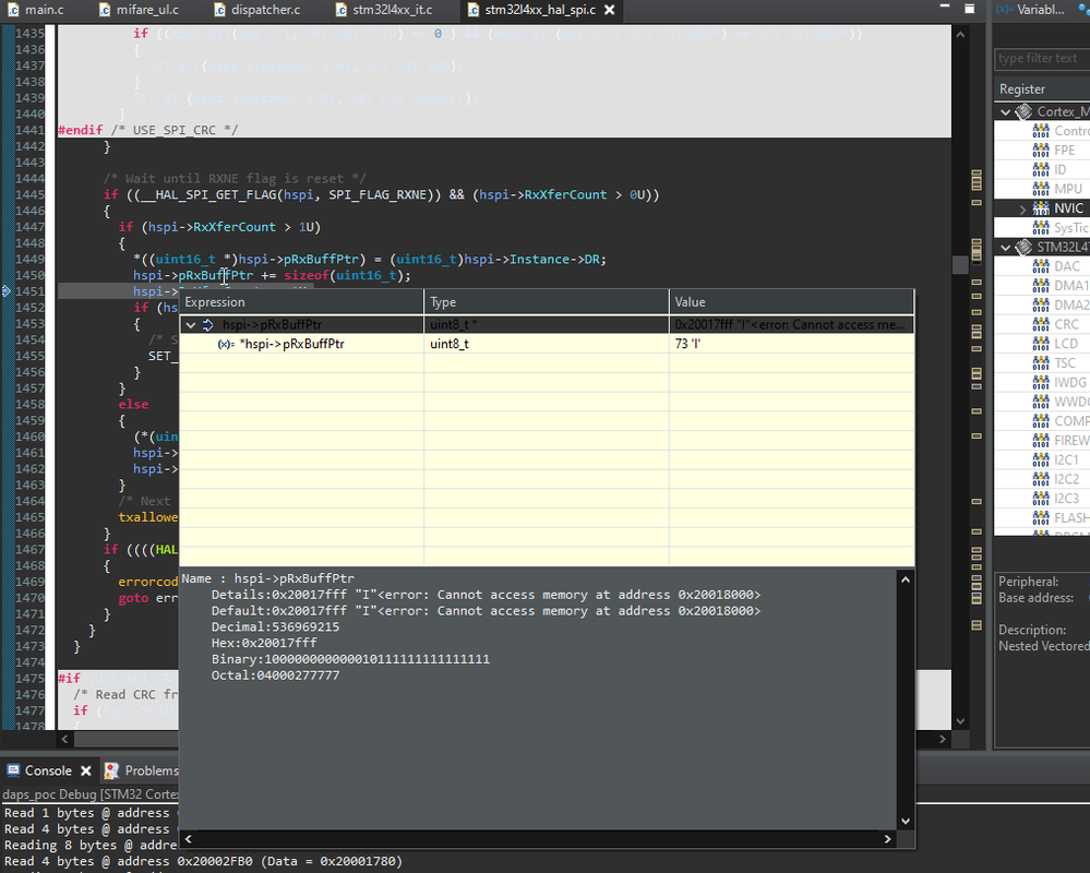

When I leave my code to play for more than one hour I received the error HardFault_Handler(), I found in registers whats the last line executed before entering in the error function, below I put a picture of this part of the code.
Note: That error is random, don't have a specific moment time when happens.

hpsi->pRxBuffPtr is at @0x20017fff which is the end of STM32L476 internal SRAM1 area. Access to next byte (@0x20018000) will cause a fault...
it looks like a HAL_SPI_TransmitReceive call with an incorrect/corrupted length parameter...

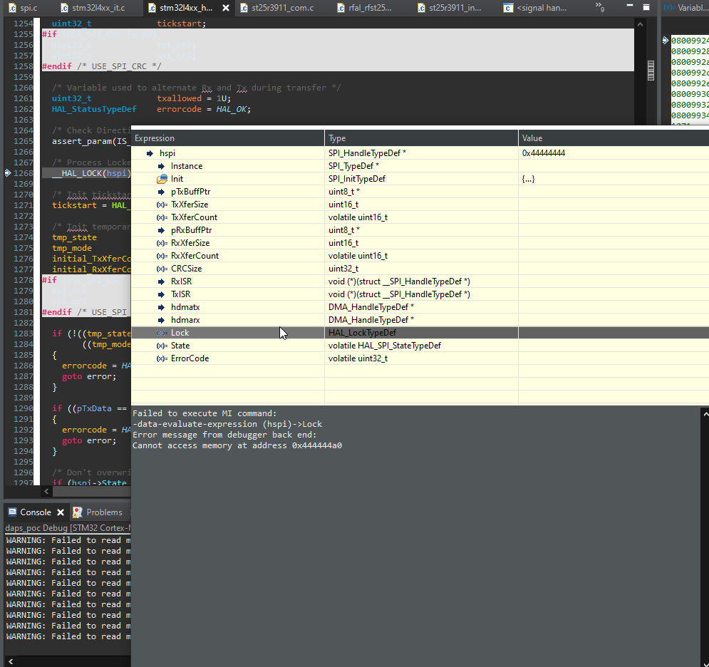

I resolve the problem increase de size of my buffer then received information by tag.
But now I had a new problem, below has a print of my new problem.
2021-04-26 1:58 PM
hspi pointer seems to be corrupted (value 0x44444444: it looks like a buffer overflow has corrupted this pointer....).
I would recommend to check buffers size.
