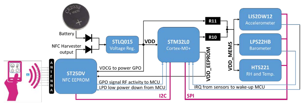

On STEVAL-SMARTAG1 there is no direct access to any SPI lines. Additionally, the only sensor that uses SPI interface is the LIS2DW12: it uses a 3-wire SPI where MISO and MOSI are connected together.

Yes, the sensor's circuit is i2c communication. But I want to use three-wire SPI communication to complete the sensor acquisition, what pin should I use to complete the circuit? Doesn't the figure below mean SPI communication?
