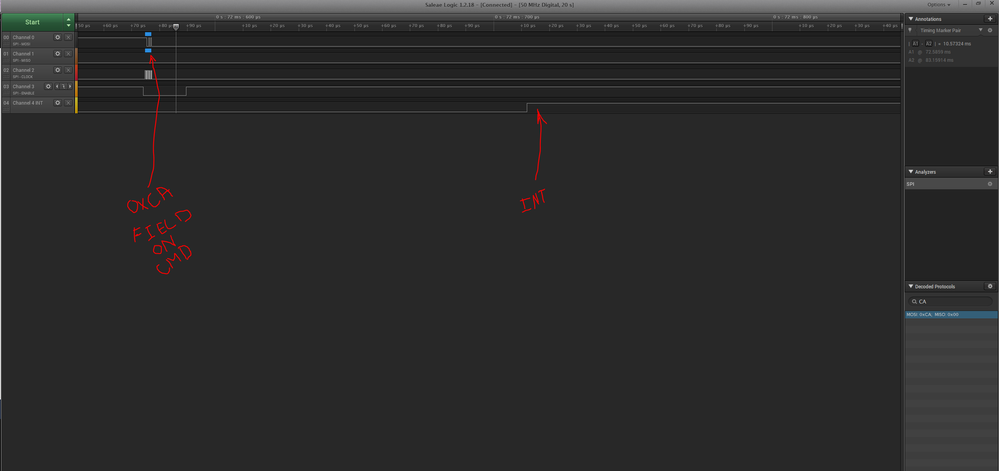

Hi Ulysses,
I am seeing the exact same issue. I checked the SPI signals on the logic analyzer and I do see an interrupt set on the INT pin after sending the field ON command is sent in the st25r3911PerformCollisionAvoidance() routine. See attached. However, I still get the return error as ERROR_INTERNAL or 0x0C.
Under what circumstances will CAT or CAC interrupts not occur?
2020-04-07 11:06 PM
the chip will always produce either I_cat odr I_cac. Seemingly in your trace it has produced one of them but the software is not reading the interrupt status register - that is why the INT line does not get cleared and software will probably run into ST25R3911_CA_TIMEOUT.
Regards, Ulysses
