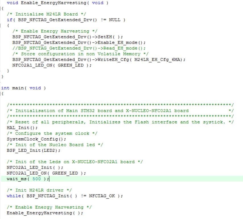

I'm starting with nucleo L476RG , MEMS and NFC02A1.I try to write MEMS data to nfc tag and its work.My problems is when i try to use energy harvesting mode, it doesn't work and i don't know why. I use the exemple within the nfc cube but it doesn't work.You can look the main function and Enable_EnergyHarvesting belowCan someone help me please?Best regardsSolved! Go to Solution.

Can you explain what exactly doesn't work in your application? The example you mention only enables energy harvesting feature on the M24LR and configures it to supply max 6mA (see for Energy Harvesting characteristics). Then you need to connect, for example a low power led, between the Vout pin and Vss pin(on the X-NUCLEO-NFC03A1 board Energy_Harvesting pin and ground), and when you approach a reader the LED should light. Kind Regards2016-07-11 5:57 AM
I don't have a low power LED but i try with a the low power nucleo L476RG and that LED2 is turn off. When i try to do the same wuth the M24LR discovery, the LED on the nucleo L476RG turn on. I just link the two board throw the power GPIO.So i don't understand where i fail with the NFC02A1.Can you help me please?2016-07-25 1:17 AM
