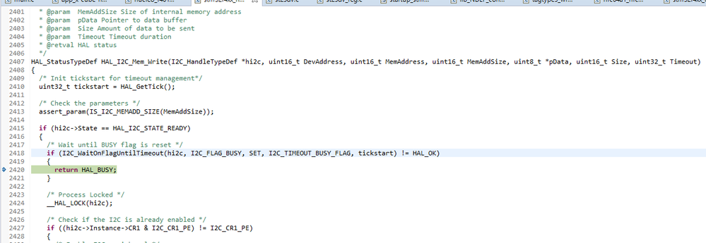

Just noticed its actually in the function HAL_I2C_Mem_Write() where there is a timeout and the function returns HAL_BUSY.

I believe I have found the problem. When the power is removed during an I2C function, the SDA line is pulled low and never goes high again, as its still waiting on data.
